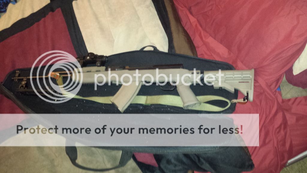

Went shooting today and had a HUGE issue with ammo jamming. The rounds weren't coming up high enough, after market clip, and then getting jammed below the barrel opening in the receiver. I have never had this issue before. I was using steel casings, and not brass like I normally do. Is this the issue?

It worked great last time I used it, before I changed out the mags stock to 30. The 30 is a plastic Tapco brand. My model D is meant to accept AK mags too, is that the issue with buying a SK mag? Steel were standard point.

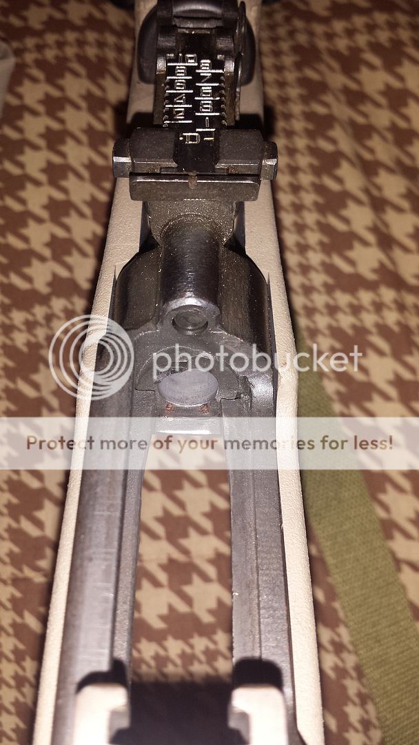

Here you can see where the bullets were jamming on each side.
So you were using a Tapco plastic AK mag? Don't take this the wrong way, but are you SURE it was fully seated? I own 6 AK mag SKSs and I can tell you that it's pretty easy to click a mag in and THINK it's in right, when in fact the front tab is UNDER the lip on the receiver. That will make your rounds feed real low.

Take 1/8" off the front of the feed lips.  Report back

I''m not too experienced with aftermarket anything on an SKS, but I'd say LC's advice is probably correct, feed lips need a bit of trim to get the nose of the bullet up enough to clear the entrance to the chamber.  It might be that these rounds you're using have a bit longer OAL than the brass cased stuff you were using and it's just enough to cause a consistent jamming problem with them.
Go slowly, take your time when trimming anything, and make sure to test the fit often so you know when you've gone far enough.  I'd hate for you to wind up with a paperweight.
