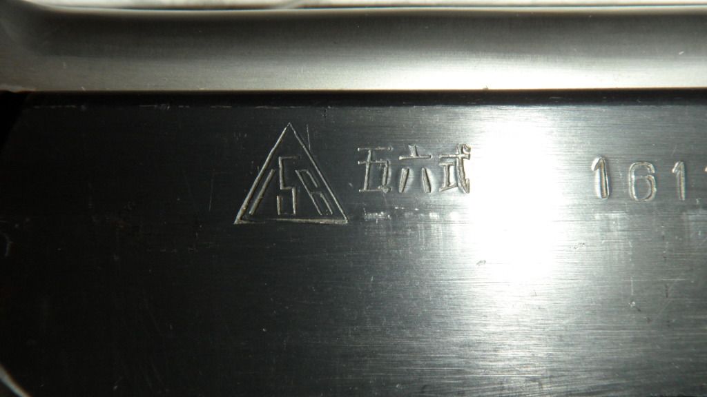

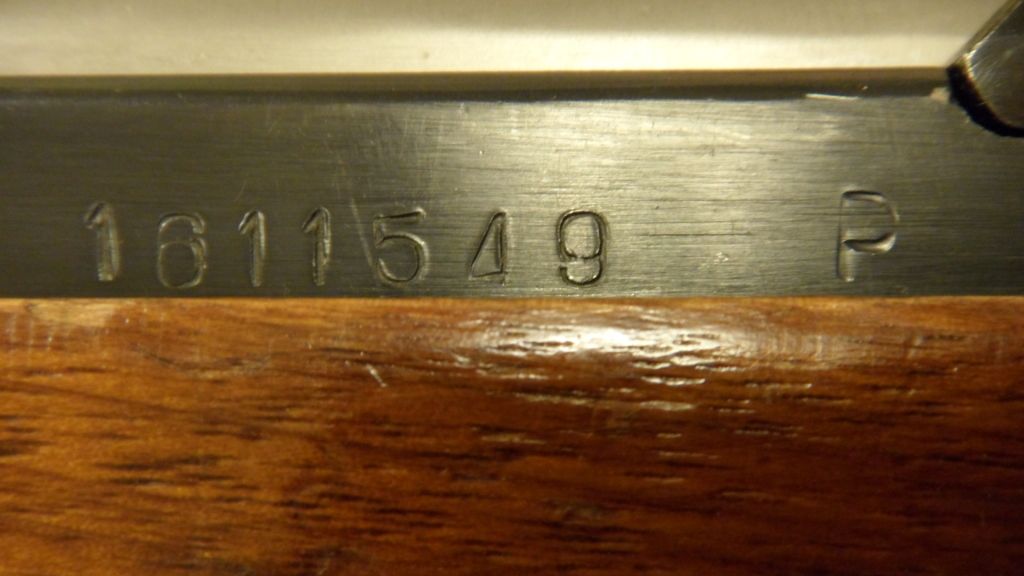

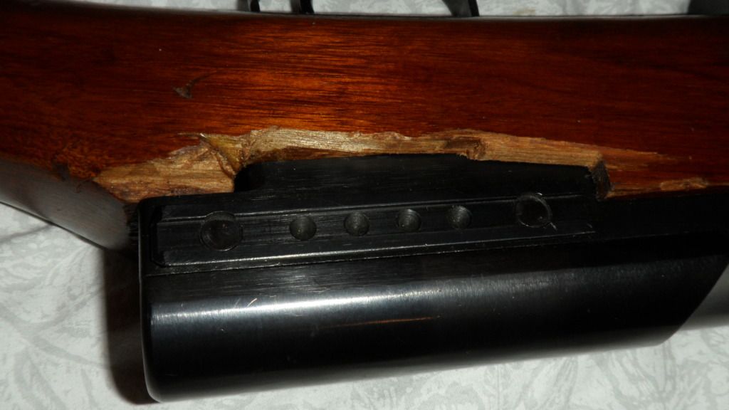

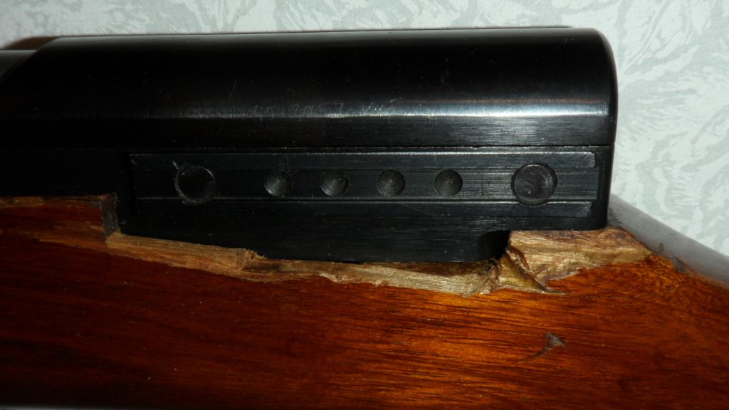

  Case in point: I bought a KSI imported /156\ with the "West Coast Rail" on it. It came through the door with a Soviet-style scope mount and decent scope, all mounted on it. Initially, it looked good. The young guy offered it to me at a "killer" price and I bought it, laid it down and went back to the show sales. After a while, I flipped the thumb clamp of the scope mount and found that the guy had apparently used an AK scope mount, found out that that wouldn't quite fit, and as best as I can figure, used a screwdriver to "make it work".
  It wasn't a bad looking Type 56...
  And then bubba decided to mount a scope.
  On an all-matching gun and stock...
  I don't know how I found it, but another identical stock with the serial number 11445 came up for sale and I bought it. Same star in front of the SN, exact same color of finish. I kept the old stock and put the "new" one on. I'd like to find a wood smith that could repair the original stock but I don't want to have it hacked. Even with the "West Coast Rail", (which I found a scope mount that will fit on that rail), I think it's worth preserving.
