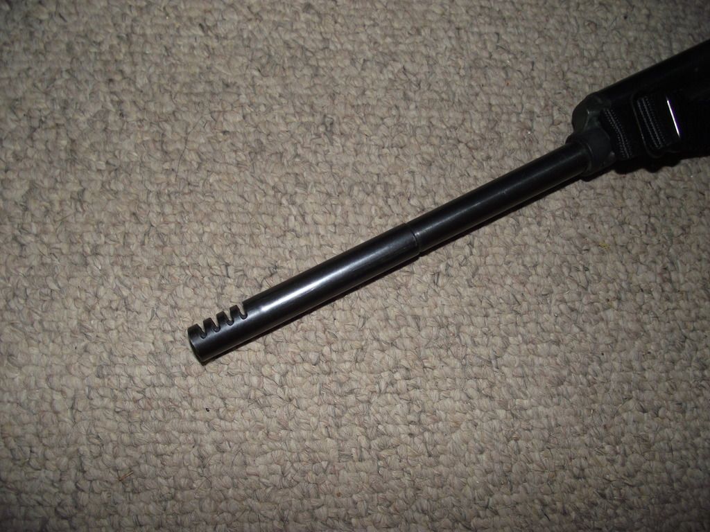

This is the very first complete accessory package for the SKS rifle.

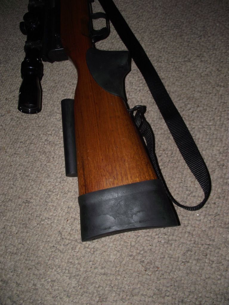

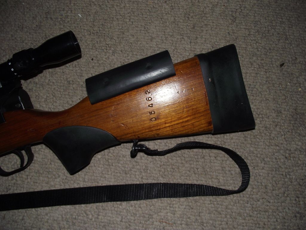

2 inch longer butt pad. This pad accomplishes two things. A longer length of pull and moves the  receiver (scope mount) forward. Allowing longer scopes to be utilized.
Sniper style grip. These are still available on evilbay.

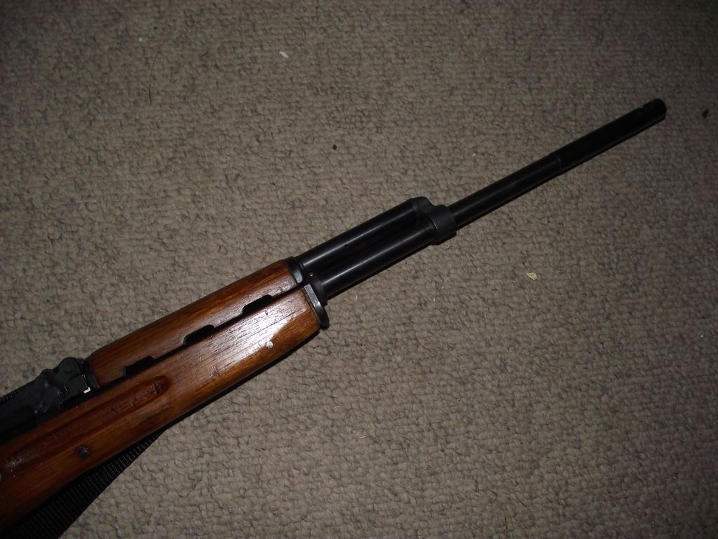

The Muzzle brake gives the SKS the smooth looks of a Bolt action hunting rifle.
The strap attached to this rifle is not an adjustable sling although you can carry the rifle with it. I use it to wrap around my fore arm to steady the rifle while shooting in the standing position. Works great.
This is the Capco muzzle brake. These fit the diameter of the barrel under the front sight. They are a very snug fit and are epoxied in place. This is not as cheap as it sounds. You will have to destroy the brake to remove it

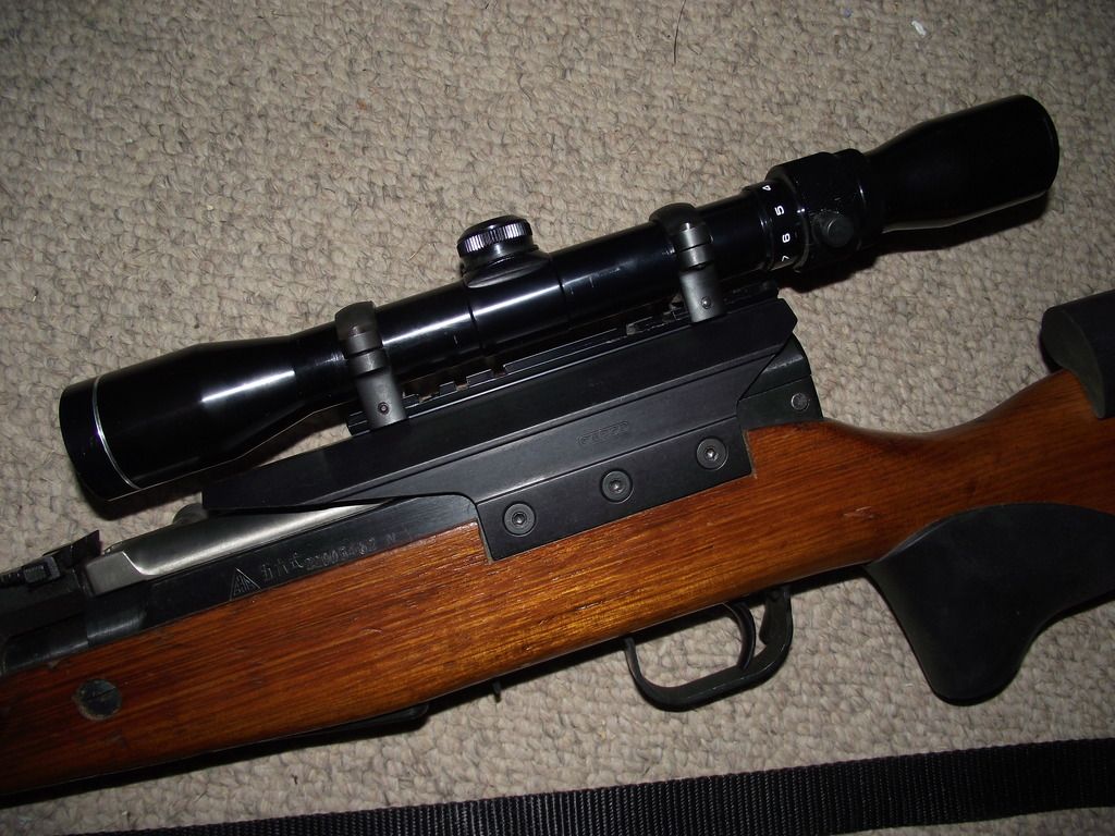

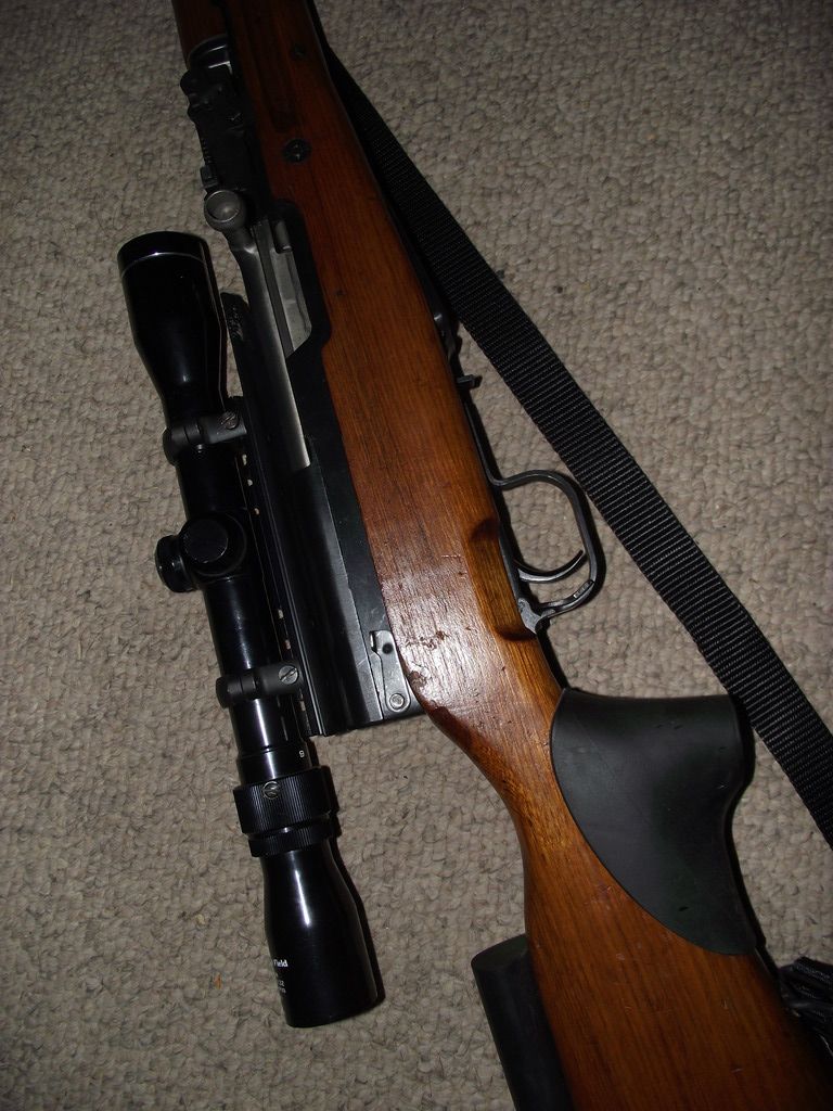

The Capco scope mount  is a well thought out design and still in demand by discreet SKS collectors today. The mount will deflect shells to protect the scope by design. The weaver rail has several inches of adjustability  allowing the use of any length scope. I have even seen the front of these mounts trimmed off to allow the use of short scopes and stripper clips.
The cheek weld with this pad is prefect. The rifle is quite comfortable to shoot

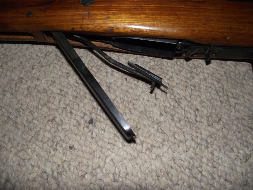

A Norinco fixed 5 round hunting mag finishes off the package.
The rifle is a numbers matching Chinese SKS from factory 636 and is in excellent condition. Appeared to be unfired when I purchased it. I once shoot a 6 inch group at 100 yards with this rifle and a different scope. I was using brass cased Yugo surplus and had luck on my side as I have never repeated the feat although I am proud to say that this rifle has 2 coyotes to it's credit.
:)..............................Joe
