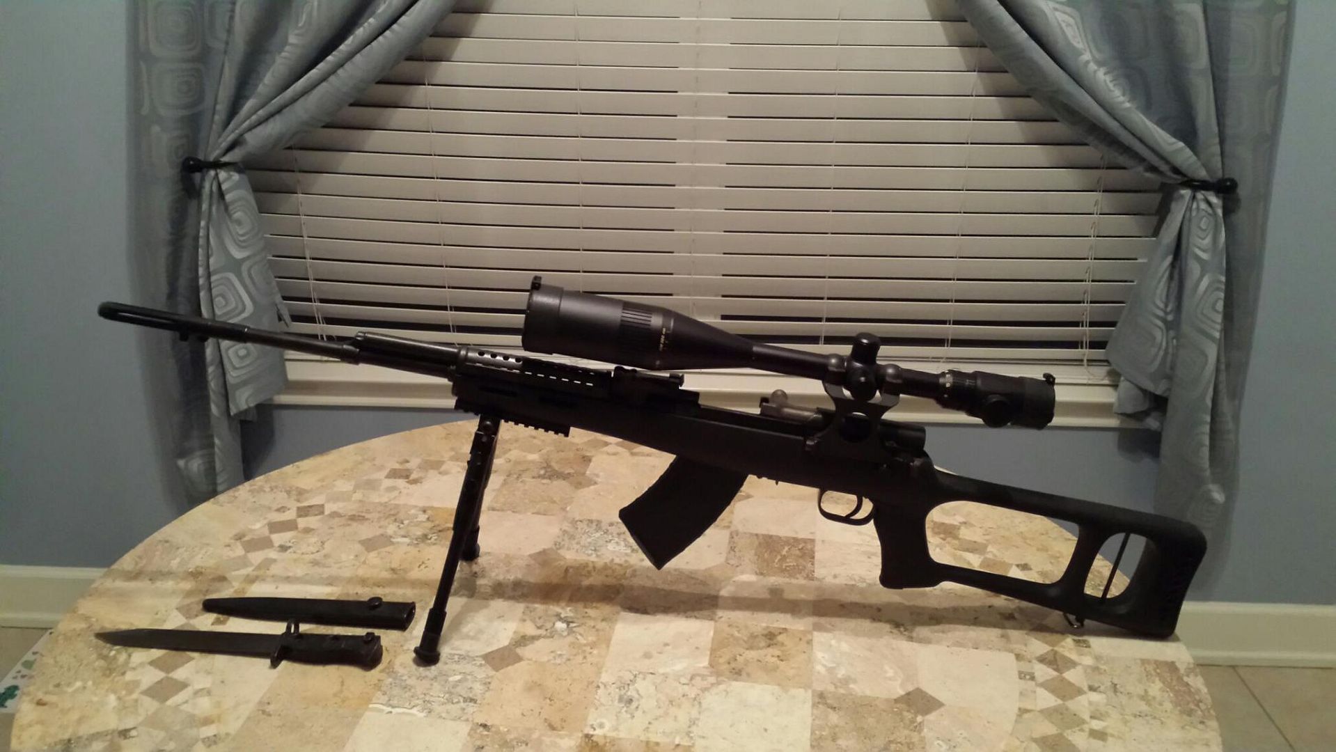

Took way to long to complete but it is almost finished.  all that is left is the shell deflector.  Maybe next week ill be able to get to that parts box and finish her. it started out from a bunch of leftover non-matching parts.

Love the L1A1 muzzle and bayo!    Very unique look!
Good to see you posting T1!
tracker1
Thanks for the good word.  been in the hell storm of life for about 3 years now.  I take some pics of my 18" barreled sks has an AK front sight with a polish stock.  I dig that one out as well

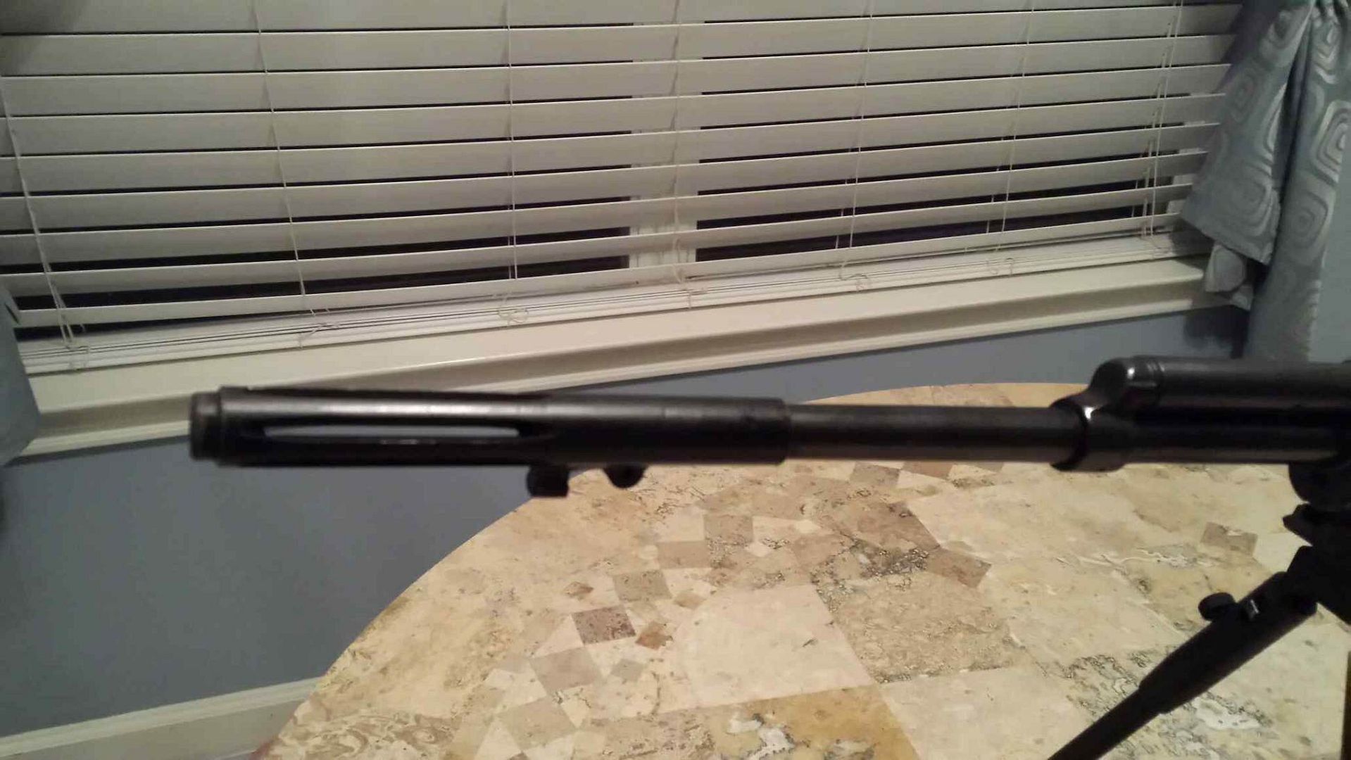

Cool to see that L1A1 muzzle brake on an SKS and Bayo to boot  thumb1
Sorry if a lil off topic but I read some where that the L1A1 Brake would thread on a Yugo 59/66 w/o modification once the GL was removed, Any1 know if this is true or tried?
Welcome Tracker  thumb1
I just read that there were FALs with 9/16x24 both left and right, and also in 14mm left and right.   :-\
Pretty sure the yugo is 14mm left

Quote from: Loose}{Cannon on August 25, 2015, 10:37:34 PM
OK I think I found out why looking this 1 up has been a bit odd...
Apparently FALs are 14 mm left hand but L1A1's are built to british specs and are "inch pattern" and are 9/16"RH but will fit on the YUGO which is 14mm RH.
Been wading through quite a bit but the 1 thing that made the most sense was done buy GreatGuns. Maybe he'll chime in, seems he's done a few personaly.
That flash hider is pretty awesome looking!  Nice job T1 and glad to see you're finally posting!  Hope things are going well for ya.  thumb1
Both FALs  and L1A1s are 9/16"-24 the FALs are LH and the L1A1s are RH. The M59/66 are M14-1 RH which is so close to 9/16"-24 that yes you can thread them on. I did this on one of my many custom jobs back in 2008. Took me a while to find the pics but here they are.

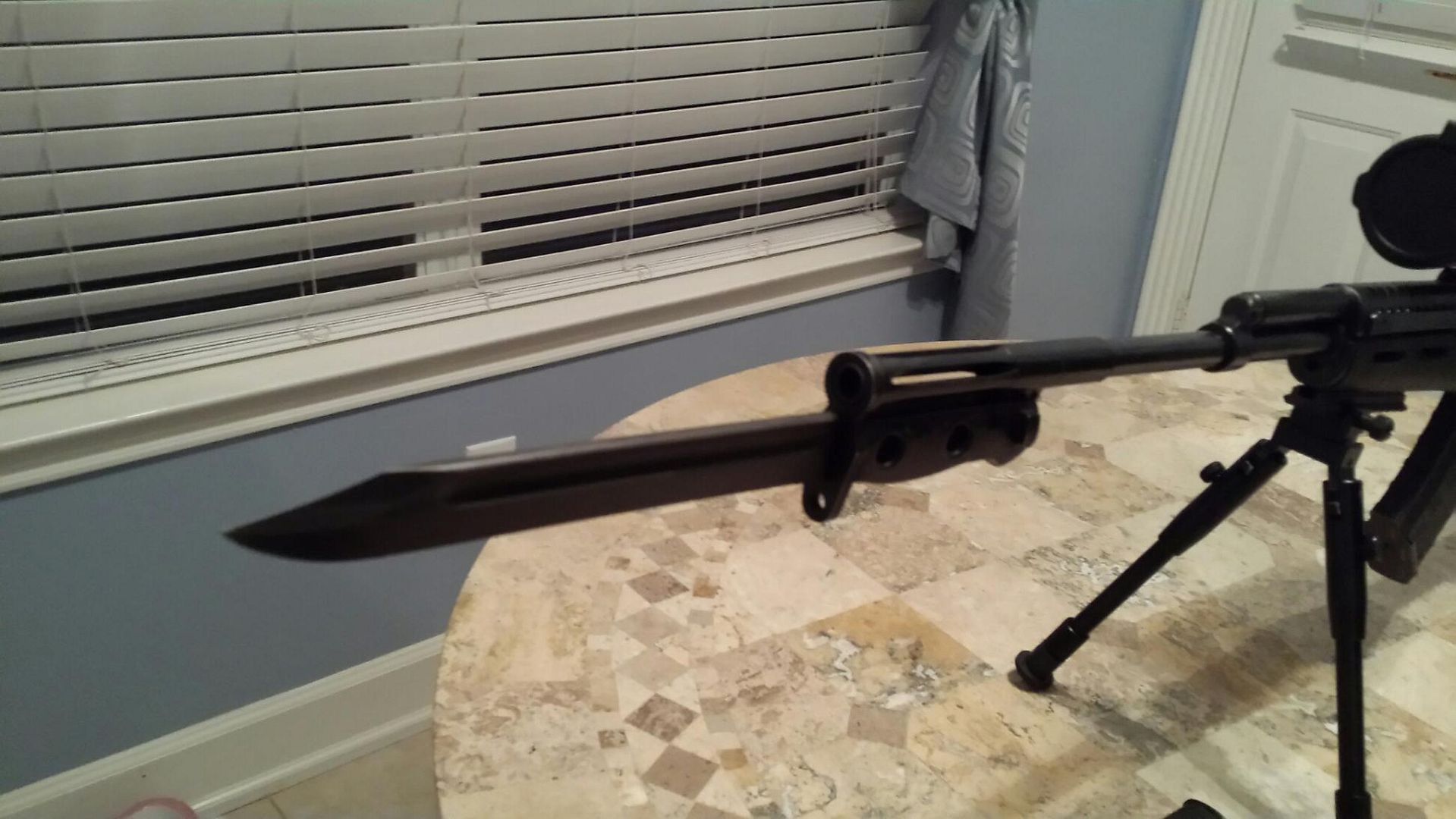

Great guns very nice set up.  My brake is th 14x1 RH thread just as the yugo.

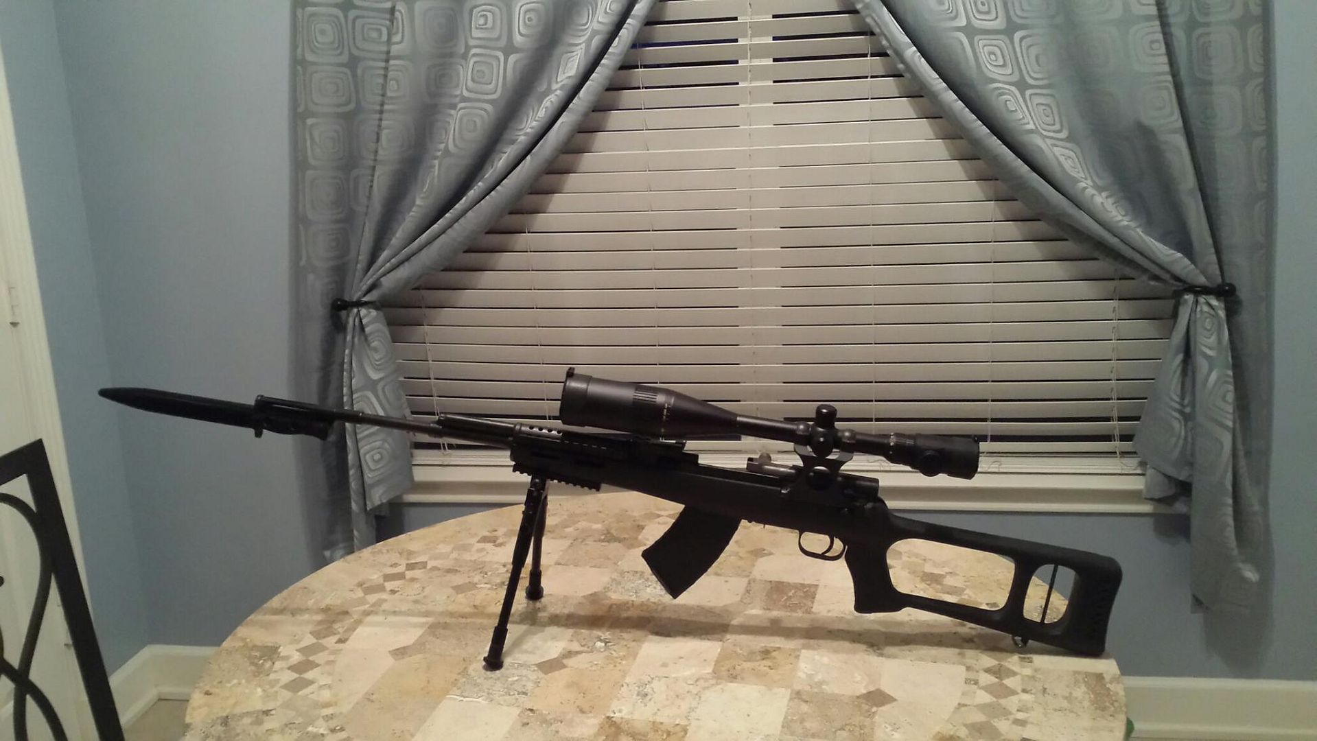

Very nice! Looks like a Keng's (or an AAI) PU sniper model (I have one as well). Nice use of the platform, and great looking mods!
