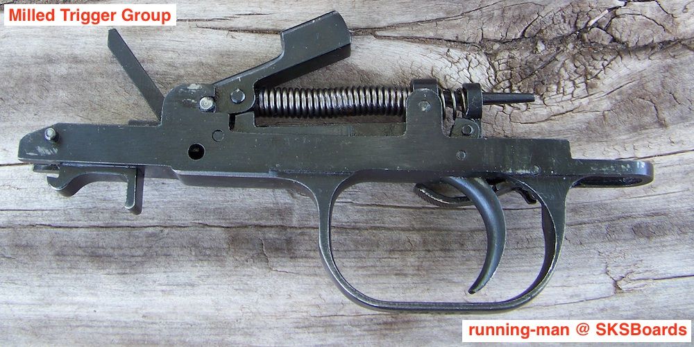

Pop the trigger assy out and post a few pics. Like LC said, some of the new production guns like the M were not stamped....but the M trigger group does have an identifying feature (stamped slots).
Photos would definitely help.
You either have a milled or a stamped group (or cast, or a special stamped group out of an AK magazine SKS).
Milled:
Stamped:
That will at least get us close to seeing what you've got.
I personally wouldn't force match what you've got. If anything you could get top dollar for it from someone restoring a bubba that doesn't want a mismatched trigger group.
