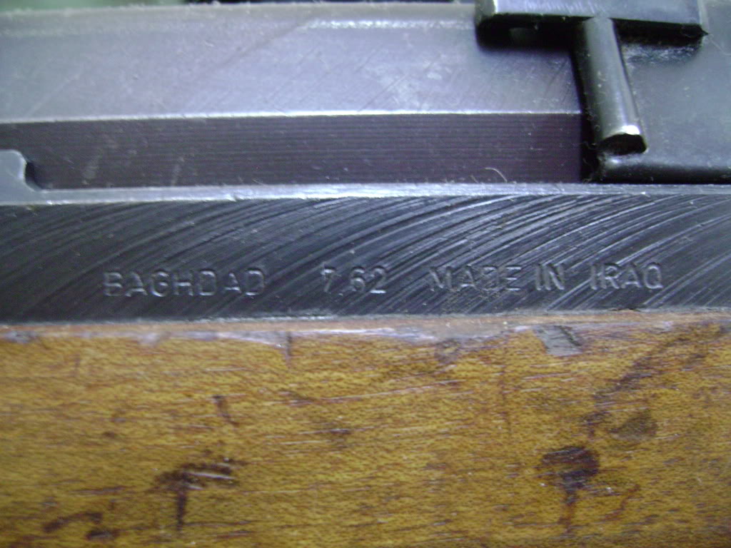

As a final note, I'll say that the Egyptians weren't the only ones to produce the Rasheed.  The Iraqis produced the "Baghdad".  Look familiar? (images courtesy of Shannon "smzeigler" @ gunboards) thumb1
Looks identical to a mini-Hakim  thumb1
MONGO want!!!!!  drool2

I'm assuming the mill work on the Rashid is better than on the Baghdad. Wow! That is some coarse work on the receiver of the Baghdad. If there are any examples in the US I can't imagine what price the would bring  :o
Ohh so it's not supposed to be an automatic. I figured it was just a perk for fun range time.
Dear Bacon And Tomato on Focaccia, this was never automatic. I authorize that I spoke purely in jest. Please don't knock on my door (again) or prosecute me or RM. Thank you.
-Blic
