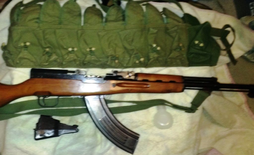

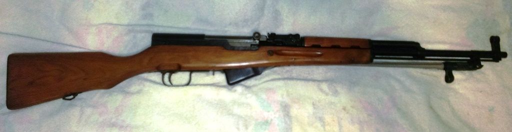

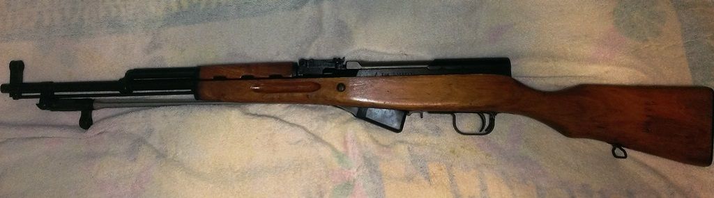

I have one from before the ban that was sold as unissued.  I have never fired it and recently removed the cosmoline. It came with a new sling, vest, and oil bottle back in the day. Arsenal is 0408.  Was it scrubbed and refurbed?  As New?  Not unissued?
A lot of you might remember it.  I tried several times to trade it off, but no one wanted it  back then.
It's hard to say with just the three photos.  It's also hard to say what configuration the smaller arsenals *should* be in (what type of lug, gas tube, trigger group, bolt carrier, etc.), because we don't have as many examples to create the baseline with.  If I saw this gun on GB, based on the three photos I'd have to give it an 'Uncertain' arsenal condition (can't tell if any of the numbers match, if it has replacement anything, etc.), and the current condition would be anywhere from 'VG' to 'excellent'.  If you showed it in the box with all the accessories, it could even garner a 'pristine'.  It's a nice gun and with a proper GB presentation, you could push $400-$500 I'd bet. Avg trangle arsenal as-issued gun this past month went for $400.  This one is better than avg.
K-9
The first photo is the top of the box.  I even have the original receipt.  Here is a poor picture of the accessories and the USA mag that they sold me with it.
There are plenty of photos of this SKS elsewhere, but I guess you don't remember it.  I will look for them.  Photobucket is horribly cumbersome.  Yeah, it is pristine.  Short barrel lug, probably stamped trigger group.  Bolt carrier and gas tube are just like any of my other Chinese, as far as I know, but the gas tube is EP'd with the serial.
