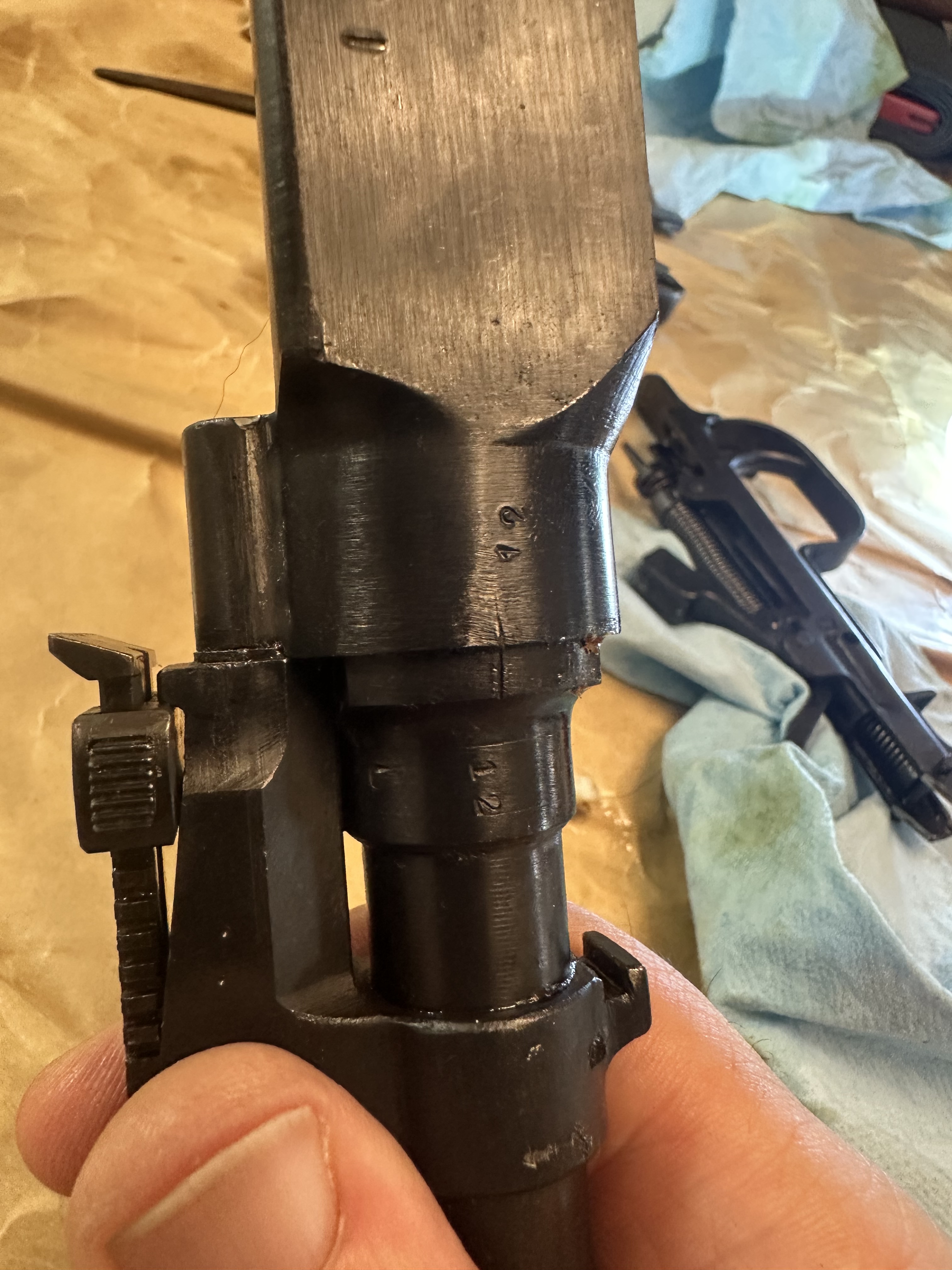

I believe this to be a late build commercial gun, not a year 12 carbine.  It is likely rebarreled as the match number on that short lug barrel is upside down which you *never* see from OEM factory barrels:
I don't see enough detail on the other parts to know whether it's a franken-gun like some of the late build commercial guns were, but I'd suspect that there could be some period incorrect parts in there.

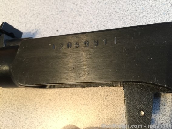

S/N 1205991, same font as the OP and has a suffix, barrel lug is not marked with a match number so it is likely a replacement.

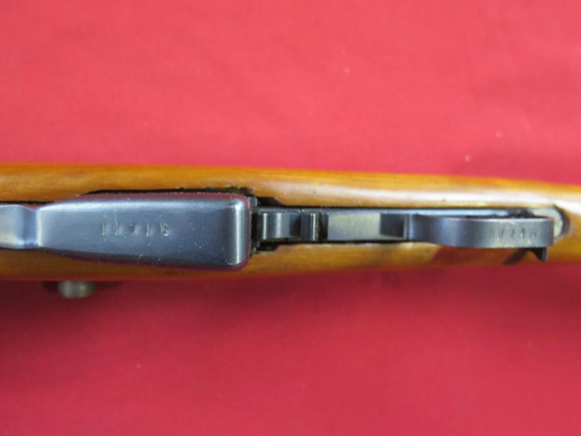

S/N 1210142, same font as the OP and has a suffix, stock font is serif while receiver and piece part stamps are sans-serif.

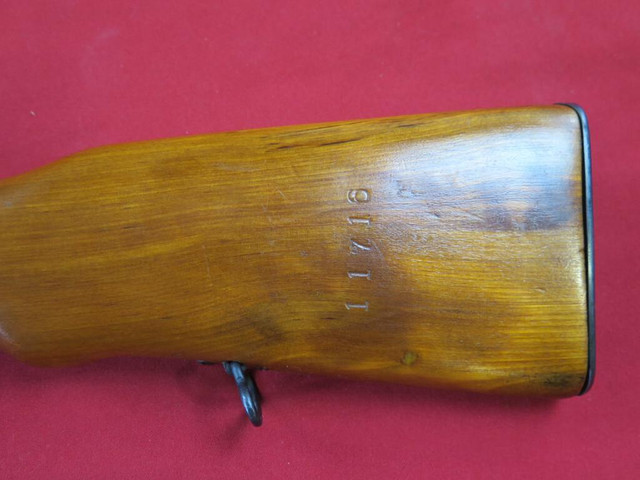

S/N 1211716, same font as the OP and has a suffix, stock font is serif while receiver and piece part stamps are sans-serif.

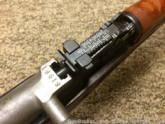

S/N 1219619, font does not match the OP, stock is a phenolic replacement, Labanau import so not a Canadian border jumpe that coule be explained as a year '2012' build.

Are there other photos you Want to see to help figure this out? This photo of the barrel lug included because I just noticed the mark on it.
