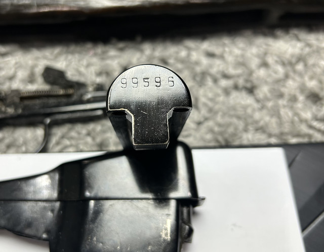

The bolt carrier on these seems to be chrome on top. I couldn't find other Chinese sks's like this from around the same time with a chrome carrier. I am also not sure if this is even the original carrier. All of the other carriers I saw were more of a matte finish whether that was how it was from the factory or from wear, I do not know.

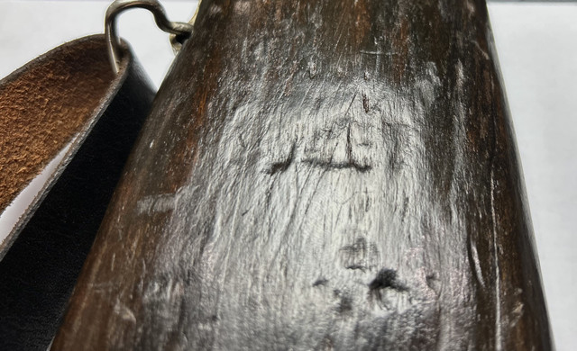

The stock on this one seemed a little off to me, primarily the color being incredibly dark, even taking pictures with my bright photo lights, some areas appeared almost black. In person the stock looks way darker.  I could only find one or two that were darker but not to this degree.  I did include a picture of the serial number on the stock but can not read it. I am not sure if this was stained or from cosmoline/dirt but the color seems to go all the way through the stock while I was repairing a crack on this. I am unsure if a certain factory used different wood or a type of finish. The wood also is incredibly soft/weak, getting scratches and dents even from my finger nail. I believe the finish on this was added afterwards as it looks and feels like some type of glossy wax, but it would be interesting to hear someone else's take on whether refinishing it to original spec is worth it. I have to fix/refinish the areas effected by the crack repair.

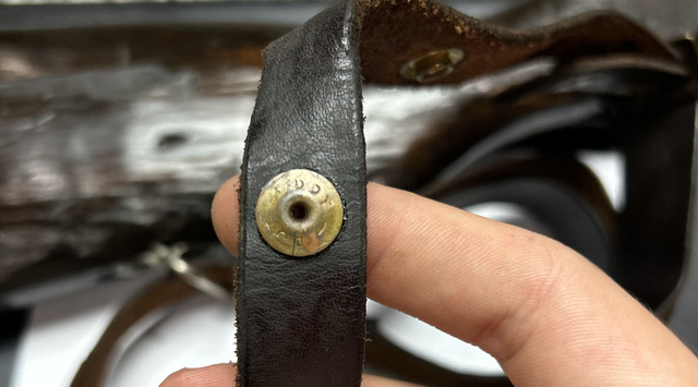

I attached pictures of the sling that came with this gun, was not sure if it was original to the gun since it did not match anything on the sks guide's accessories list. I do not believe it is original due to the DOT marks on the snap buttons.

The heavily worn arsenal stamp and metal refinish introduce the possibility that a previous import stamp could have been removed. The indexing number on the receiver (15) is also heavily worn, while the matching number on the barrel is still very crisp. As well, the carrier is  so shiny that it looks almost to be chrome plated. IMHO, this rifle has had a healthy dose of the buffing wheel

1) This gun is a hodgepodge of parts.  In my estimation none are original to the carbine.  I don't see a single S/N that matches in all these photos which is pretty amazing.  Usually you see at least one or two that match (carrier and bolt for example.)  The stock is not original to the gun, but it has a rudimentary cut for the inverted takedown lever that this year 12 carbine has.  Year 12 corresponds to 1967 based on the SKS-Files dating scheme, BTW.
2) Many of the 'odd' looking features that are throwing you off were brought about by attempts of the previous owner to stabilize/restore it.  The black paint on all the parts is most certainly something done stateside as it encompasses areas of old pitting and is flaking off in many places.  It was also applied thick enough to completely fill in the interior of the light /26\ arsenal marking rendering it unreadable as well as portions of the RSL numerals.  Similarly, the very liberal finish on the stock (the crossbolt is liberally covered in something very yellow, I had to make a second look to make sure those parts were not made of brass!) was certainly applied long after much of the initial damage to the stock occurred.  It being so soft could easily be from rot as a result of a humid environment...like Vietnam.  Of course going to the extreme other end, this entire carbine could be a frankengun put together from parts by someone stateside who made up a story and buffed off the import stamp.  I really lean towards it being genuine, especially since you purchased it from the vet's family, but at this point all you have is a gun and a story.  It's not worth terribly much in its current condition I'm afraid; I'd estimate it fetching towards the low end of typical Bubba'd carbine.  Papers would add another couple hundred...maybe, but the current condition is a killer I'm afraid.  There are many other potential VN bringbacks out there that have not been 'restored' to this level that would be much more desirable to your avg. collector.
