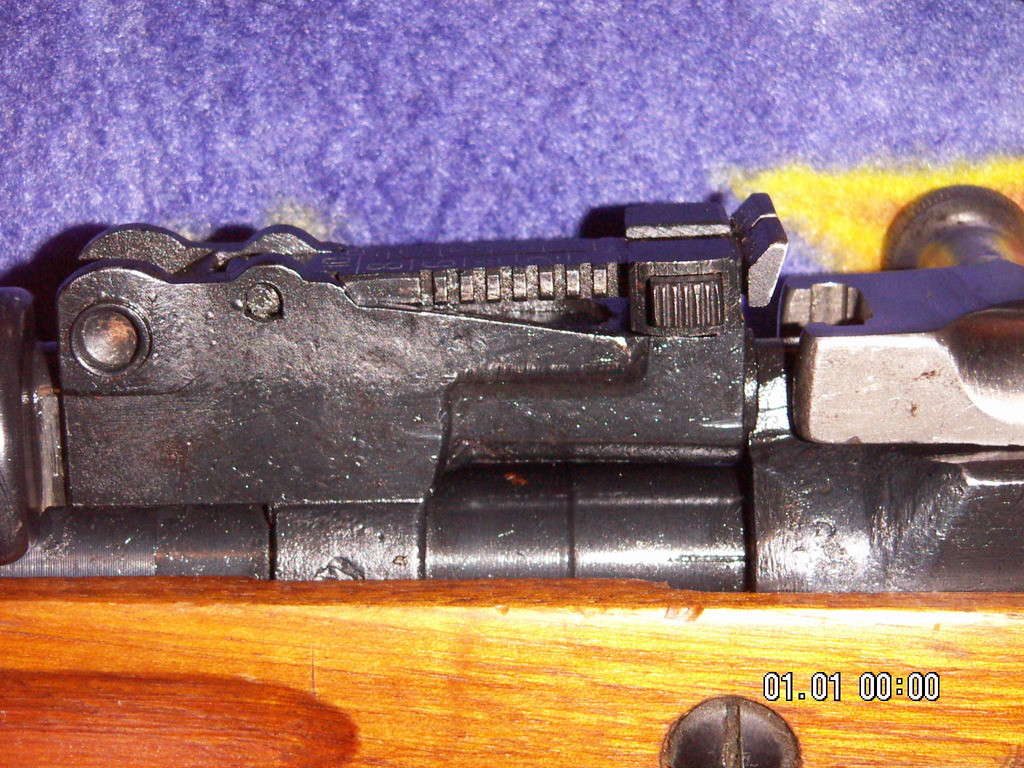

Here are some pictures of an SKS I received in February of 2014.
Very nice.
Large font serial on the stock indicates late series production. Possibly as late as 1961.
Definitely among the finer examples from the Albanian caches.
Nice! I'd say a 1960. I wish a rare, mythical (non-existent?) 1961 Type 53 would show up to stamp a solid boundary (or not) on the prefix letter guns.

Definitely a real beauty and a 100% keeper in my book.  Those letter D's with matching stocks just don't pop up very often at all.
I'm not opposed to the idea of letter guns spilling into '61, but there's not much evidence to support that one way or the other.   If we are tossing ideas out, another option is that there were two lines running simultaneously during letter gun production and the large font / narrow font guns were actually made concurrently in '59 with '60 being a completely empty year and '61 the year when they had to slowly ramp up 100% domestic production with the 6 million /26\s.  It's likely going to be one of those things that we know a date range, know what came before and what came after, but may never know the exact 'born on' date of any particular carbine in the letter series.   thumb1
