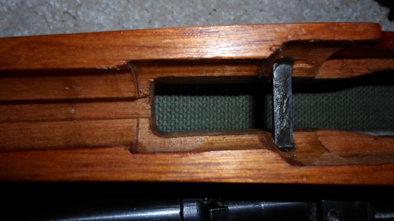

It's a pinned barrel, but the stock has the relief cut for the short lug threaded barrel, and the crossbolt does not look shaved or re-positioned.
So, were there still threaded barrel stock blanks floating around in 1971 that still needed to be used up?   Or was this one rebuilt/restocked at a later date?  What say you?

Hmmm.  Good example, GM.  I'm not sure that a stateside bubba would have either the resources or talent.
For those of us who have tried to swap stocks from a threaded  to  pinned actions, we know that crossbolt placement will not allow a fit - not enough clearance.
So a stock which has the relief for a threaded barrel lug would need to have the crossbolt installed about 1/8" forward to work on a pinned action.  I would think that a procedure like this would be done only at arsenal level.

I know that the lugged receivers are a near impossible fit in the stocks for pinned-barrel receivers without modification to the fit. (Right?)
But does this apply inversely? Will pinned barrel receivers drop in to the lug-barrel stocks and generally be loose?
Does this rifle's stock have any  indications of modifications to the inletting or crossbolt (other than the gap at the barrel base)?

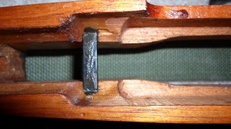

Here is the inletting in mine.. crossbolt was put there once, no modification, grinding or moving.
martin08
My stock is the same as GM's.  The crossbolt location was never changed.
