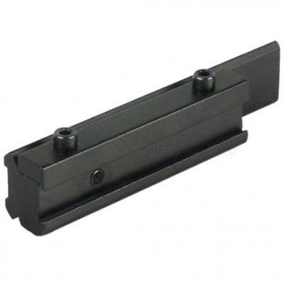

I have thought about this mount for a long time and here is what I came up with. There are many dovetail to weaver adapters out there and I have checked out several and came up with this one. These things are pretty cheap.
http://www.ebay.com/itm/Scope-Adapter-Rail-Mount-Crossbow-3-8-Dovetail-to-7-8-Weaver-w-Stop-Pin-/161077196326?hash=item2580f2f626
Here is the pics if the link dies
Note the allen screws holding one side of the dove tail to the adapter.
Remove the two screws and the dove tail side. file down the mating surfaces enough to tighten the tolerance on the dovetail. This mount is equipped with a set screw in the center. This screw will line up with one of the divets in the K-Sports rail and tighten as necessary. Filing the bottom of the mount or releaving the stock maybe necessary I don't know. Mounting to the rail is done.

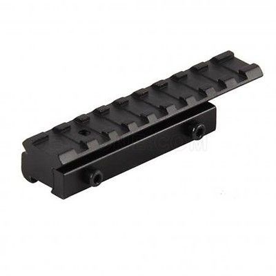

Next remove the lugs on the weaver rail (top pic) with any means available (mill, end mill in a dril press, file or sand paper on a piece of glass). This mount is thick enough to weld a piece of angle to it or drill and tap several holes along the side and mount the angle that way.
You can get real small quantities of aluminum angle from Aircraft Spruce and Specialty.  2 x 2 x 1/8 or 2-1/2 x 2-1/2 x 1/8 is available.

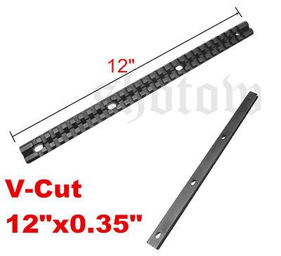

You will still have to mount a weaver rail to the top of the angle. Bulk rail is on Evil bay for cheap. Cut to fit drill and tap.
http://www.ebay.com/itm/V-Cut-Style-12-Inch-X-0-35-Inch-Uncut-Blank-Picatinny-Weaver-Rail-12-x0-35-NEW-/321318963470?hash=item4ad01a490e
Here is the pic if the link dies.

Yeah Joe, that dovetail to picatinney rail adapter was the first thing I looked at. The thing that killed it for me was dealing with the screws that lock the dovetail down. Might be difficult to get to once the rest of the mount is welded together. Didn't care for the amount of welding or D&T either.
I'm going to start with this;
I will make a spacer to fill in the gap on the rail mounting portion then simply cut and re-weld the the picatinney rail portion to the correct height. I may end up cutting the back of the mounting area off in the back along the rear most set screw or right behind it. Won't know exactly where until it arrives and is fitted.
My other option is to take the top portion of my AK scope mount and weld it to the adapter mount that you mentioned, but I'd still have the issue of getting to the mounting screws which would either be facing down into the stock or up inside the rail bracing which could make it difficult to get to. I guess I could D&T the bracing onto the adapter, but then one wonders if it will hold. Screws being a potential weak link and coming loose and all from recoil.

Well Joe, I got the AK mount and after playing around with it I decided to combine our ideas. I am going to cut down and use the AK mount top portion, but I ordered the 11mm to 20mm adapter rail you suggested and am going to work with that instead of the spacer idea. This way I can D&T into the adapter and actually may not have any welding to do. Price of parts vs price of welding labor offsets.
It also dawned on me that if I make sure I can get the receiver cover off with the mount installed I can get to the dovetail clamp screws from the top with a hex key from across the top of the receiver so it won't be so hard after all. And, I can still utilize the set screw into the divots to further lock it into place. Should actually be minimal work.
