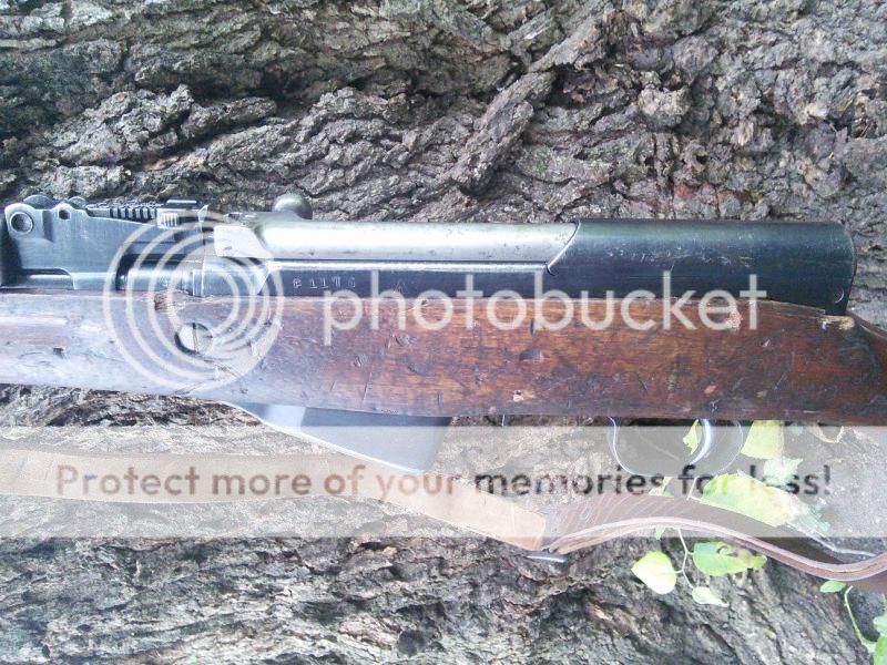

Sometimes those Russians seemed to hit only one particular area with the 80 grit.  Take this one for example:
This stock is off a 1954 Tula that I traded to Blicero for his POS broken Rasheed.  It's a very light refurb (a Liski at that!), with all '54 features and a receiver cover that looked like this:
The shellac brush and coarse sanding marks really give it away, but just going by the cartouche and date, they don't look too dickered with (aside from being filled in with shellac).  The Russians really don't surprise me with anything anymore.   All things are fair game it seems.  That's why I will continue comment about anyone claiming to know the true refurb status (or issued vs unissued, fired vs unfired) of any given Russian SKS as being a total pipe dream.

It was a looker, that's for certain.  Draco used to own it several owners ago actually.  Here's a couple of his photos of it from many moons ago:
