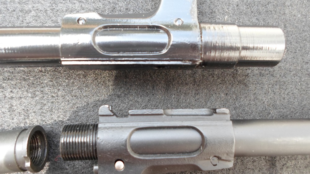

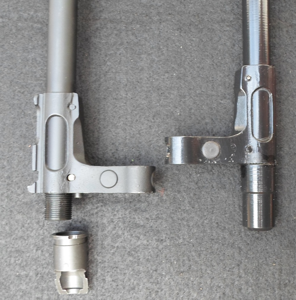

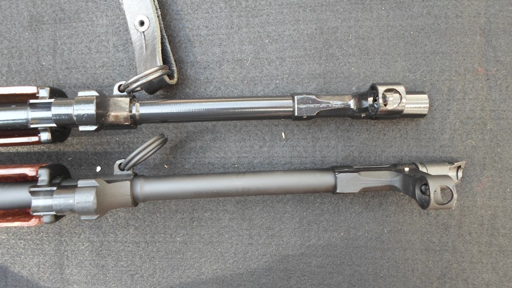

First up, the front sight assembly. First off, the Czech version uses the original barrel, which according to U.S. gun laws is to short, it was 15.4 inch long, so too short by one inch. To be able to use the original barrel there is a permanent barrel modification to bring it to the required length.The Century version uses a Green Mountain manufactured barrel, the standard length, the end of the barrel is threaded, which allows the muzzle brake to be removable or changed. Now one other difference, the Czech made barrel is as I understand, hammer forged and chrome plated inside. The Green Mountain barrel, if they use the same steel as their Ak replacement barrels is the "finest quality 4140 steel". Some have claimed the Green Mountain barrels, at least the early ones were .308 dia, not .310/.311 as the original. I didn't go that far to verify, claims were "possible short barrel life due to wear". I believe the Ruger Mini 30 was the same way at some point, but I could be wrong, and there is alot of those still out there.
One other difference, the Century you can attach the bayonet, the Czech version you can't, the bayonet lug was ground away, I'm guessing an import vs. built in the U.S. law.

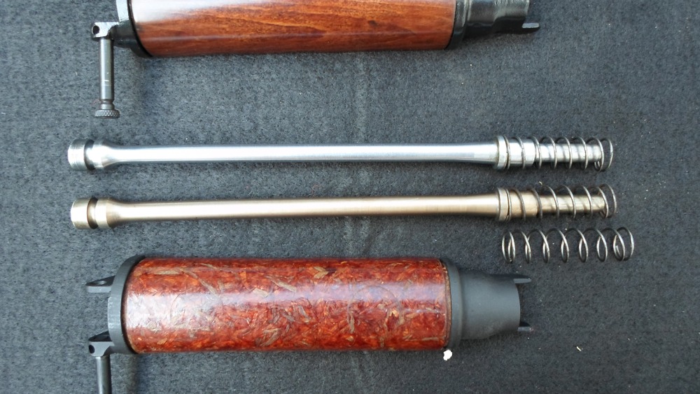

The gas system, no differences noticed, all of the parts were all interchangeable, even handguards. The extra spring was found in the Vz2008 cleaning kit, figured I'd show it.

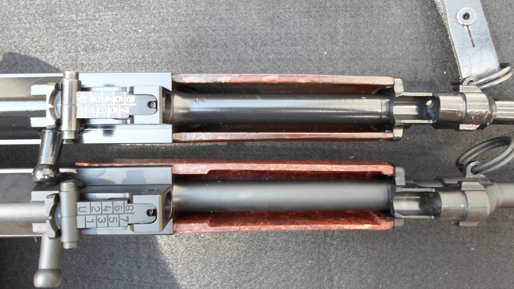

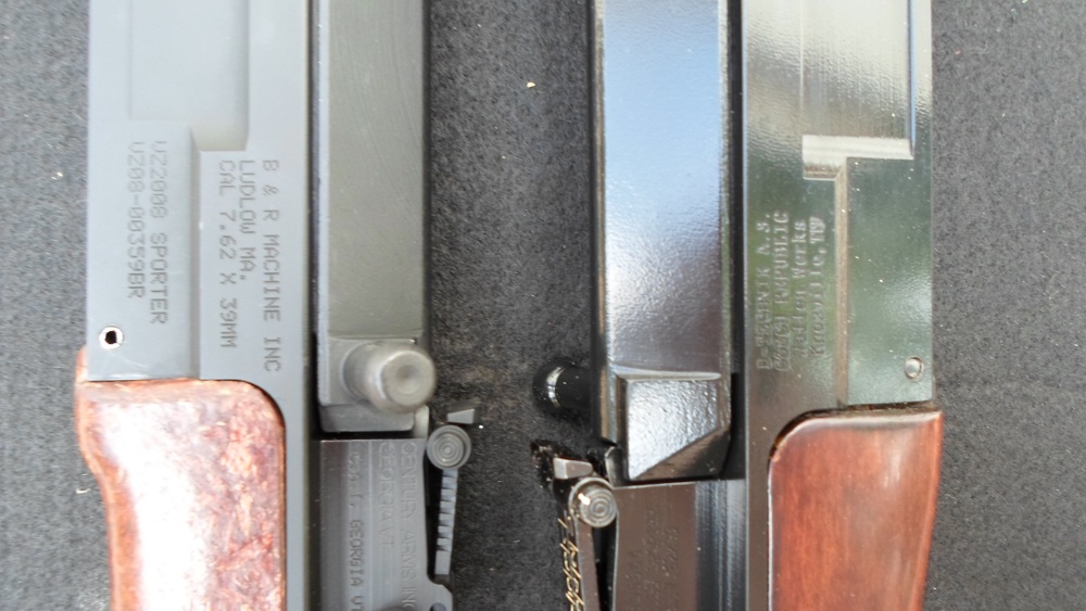

These are two top side photos, side by side, notice how the Century front sight assembly is slightly more forward. Same front sight base, just slightly longer barrel. Same rear sight as well, the "U" sight setting is for "univerzální" meaning "universal", the basic battle sight setting for out to 300m.

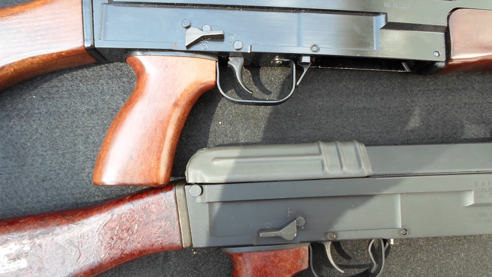

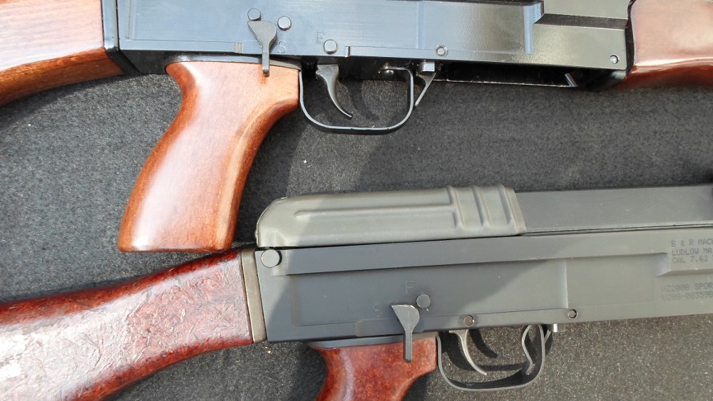

Now something a little different, the safety. Both in the down position are on safe, the Vz 58 rotates facing forward, the Vz 2008 rotates facing back. Both rotate only 90 degrees.

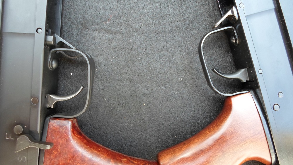

Another difference, the trigger guard. Seems there is two different trigger guards, at least listed on the Numrich site, one wide, one narrow. The Century, at least my example, seems to have the wide guard, which once you get used to it, the mag latch is not an issue. The Czech, it's nice, easy, flip and instant mag drop, push forward to drop the mag on both. Also some small machining differences in the mag well can be seen. The button above the mag release is a bolt hold open for when the mag is removed. Pull the bolt back, push it upwards and it holds the bolt, pull the bolt back, it releases and the bolt will close. NOTE, bolt locking lugs engaged into receiver, thats how and where the action locks shut, till the recoil pulse comes and causes it to unlock.

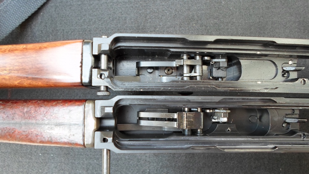

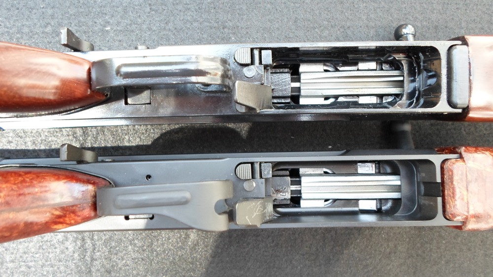

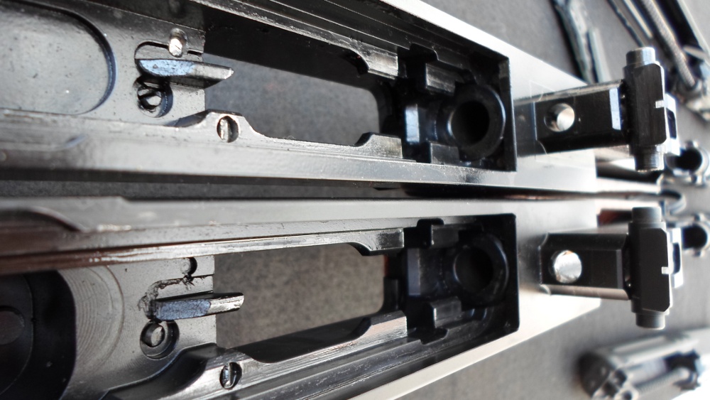

Receiver differences, just some small differences in machining, either way must work fine. Also noticed some small external machining differences, none of which would affect operation. In all photos, the Czech version is at the top of the photo. Neither of mine were drilled for the side scope mount, but the flat for such addition is present.

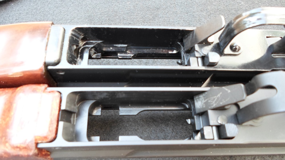

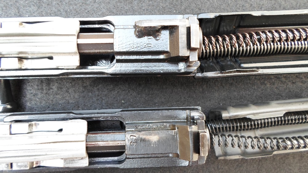

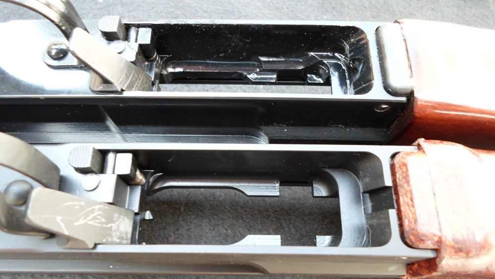

The trigger mechanism, some differences, I didn't venture to tear either apart. But, I did find the bolt carrier seems to be configured to work with it's respective receiver builder, at least in stock form. See photos and description below. Trigger pull between the two, in my opinion is close.

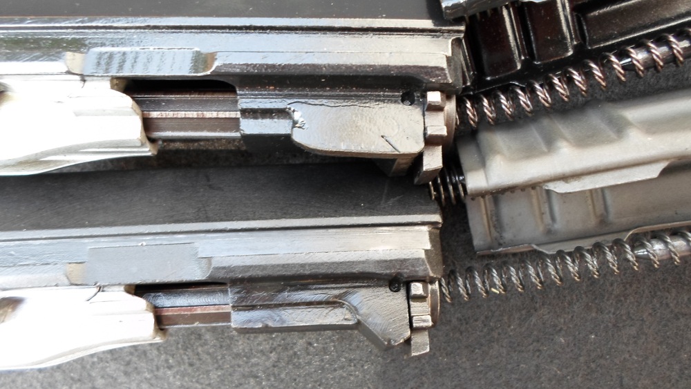

The bolt carrier is different, this was the only part I found I could not swap. the actual bolt, locking mechanism, hammer, springs and cover seemed all interchangeable. The bolt carrier would insert into the others receiver and each would move 1/4 inch then lock up. Seems the trigger, safety and bolt carrier are the incompatible parts. I'm sure if someone wee enterprising and got desperate, these pieces could be modified to fit. Again the Czech built one is on top, it looks to have a welded ear on it, possibly for the disconnecter, where the Century doesn't. This may have just been a different way to convert to semiauto along with trigger modification. That is what seems to cause the swapping issues. I would for safety sake do a headspace check and/or have a gunsmith inspect if any of the bolt, carrier or locking mech. is changed, just for piece of mind.

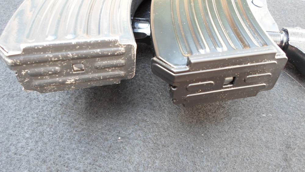

Here is a standard issue surplus mag you can get anywhere with a CzechPoint mag. The CzechPoint versions are either new production or refinished surplus, painted black and have a plastic base. Again with plastic. And I'll throw this out there, all are last shot bolt hold open, unlike the Ak, where you need either Yugo mags or aftermarket mags. The stuff like the plastic magazine parts and trigger are known compliance parts, due tothe fact the D-Technics is imported and not built here like the Vz2008.
